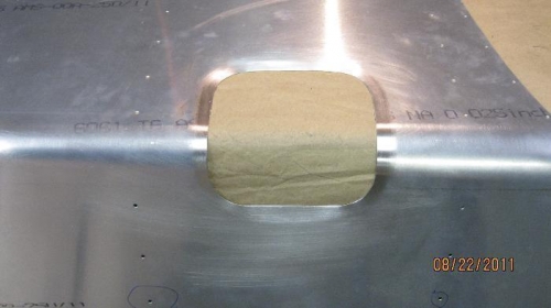

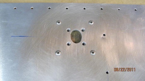

Brief Description:  Cut Landing light hole. Cut pitot hole and bracket
Cut the bottom of the leading edge skin landing light hole. Cut the Pitot tube hole and made a new bracket that included nut plates so that the pitot could be easily replaced. I also clecoed the top skin in place and re-installed the flap and aileron to check again for proper clearance. I am happy with the fit and it looks good to me but I will have other more experienced builders look it over also in addition to the EAA Tech counselor.

Landing Light cut-out.
Pitot Tube cut-out. Mounting plate not visable.
