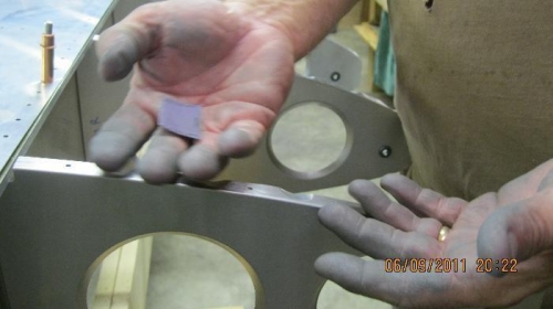

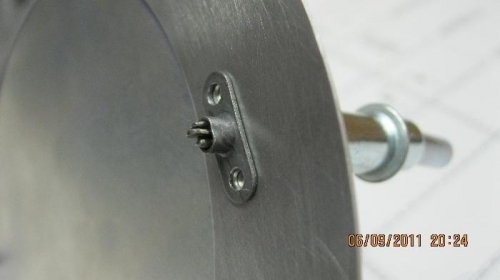

Brief Description:  Inspection plate ring. Deburr top LE edge ribs.
Today I made a .025 ring to add strengh to the inspection hole if needed.. I have not deciced if I will install it yet but it seems that .025 skin and inspection plate is rather thin when you consider the number of times it will be off.for inspection. I am also installing nut plates on the inspection hole. It would seem easy to strip out the small sheet metal screws.
I spent 1.25 hrs deburring the forward ribs and looks like many more hours to follow.
Ring, Inspection Plare Cover, Nut Plate.

Deburr rib edges and rivet holes.

Not real fun and many hours to go.
