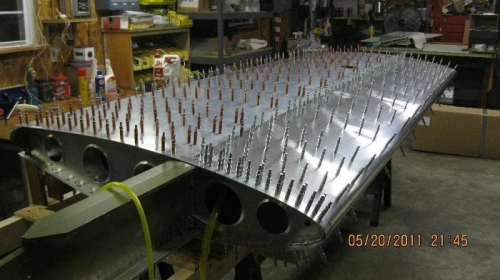

Today I found a little time for the wing. I updrilled a few hundred holes in the top skin and the leading edge skin.. I also Measured, measured again, cut, deburred, fit, measured, clamped measured, drilled number 40, clecoed, updrilled number 30, and now the Aileron and Flap hinges are fit and clecoed. I am now ready to remove the skins and start what seems like days of deburring.
Another look at the num,ber of holes.

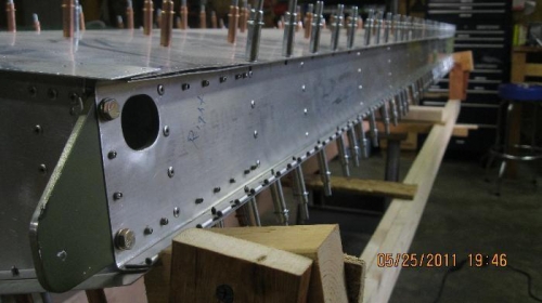

Aileron and Flap hinges.

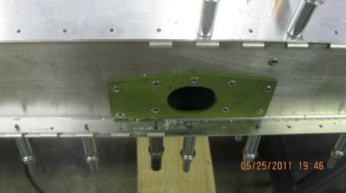

Hinges fit and clecoed.
