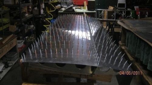

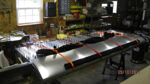

Brief Description:  Clecoed Forward Skin to Top Main Spar of right win
Today I verified that the wing frame is in perfect alignment and then started to cleco the forward skin ( Leading Edge Skin ) to the Top Main Spar and all Forward Ribs. Bill Nellis helped me flip the wing and verify alignment. I used the ratchet straps method to pull the forward skin into place. I will cleco the bottom tomorrow.
I also ordered anchor nuts for the inspection cover plates. The plans call for sheet metal screws to hold the inspection plate to the lower skin, however I think it is better to install the nut plates. It is less than $4 for parts.
Clecoed and ready to flip.
Ratchet Leading Edge Skin into place.
