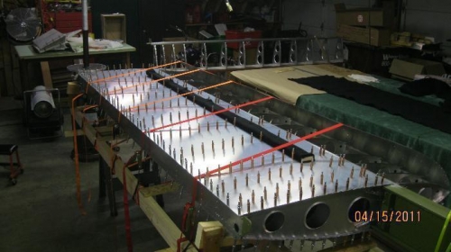

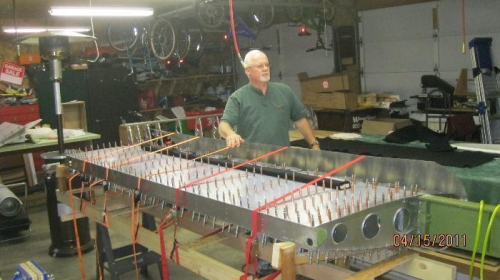

Brief Description:  Placed Ratchet Straps to pull Leading Edge into po
Today I secured the ratchet straps to the wing in order to pull the leading edge into position to drill and cleco. I used 5 straps and just started to pull the leading edge.
I will continue tomorrow and hopefully finish drilling and clecoing the leading edge and updrilling the top and bottom skins.
Ratchet Strapes pulling Leading Edge into place.
