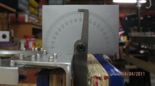

Brief Description:  Removed right Forward Root Rib.
Today I am removing the right wing forward Root Rib Attach Angle. In addition to removing some material from the ends to allow for the skin rivet, I needed to check the angle of the Attach Angle because the rib did not match the predrilled pilot holes in the skin.
I found that the angle is 89 degrees and should be 86 degrees. I think the only solution is to drill out the rivets to remove the rib from the attach angle and then try to close the angle to 86 degrees.
Root Rib Attach Angle should be 86 Degrees.
