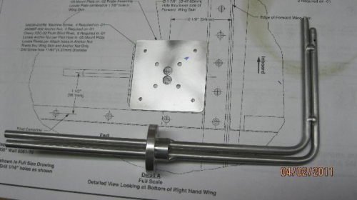

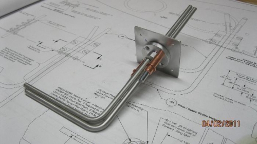

I also fabricated a mounting plate for the Pitot/Static tube which I purchased from Aircraft Spruce.

Pitot/static tube & mounting plate.
