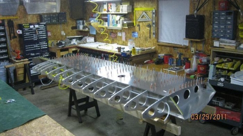

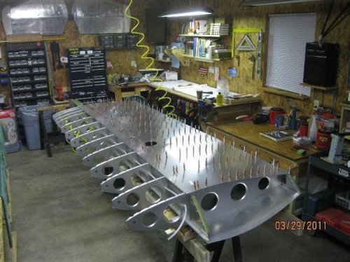

Brief Description:  Fit and drill bottom skin on right wing.
Today I positioned the bottom skin on the right wing. Much easier than with the initial fitting of the top skin. All ribs lined up great. Pilot drilled number 40 holes and ran out of clecos so I updrilled the pilot holes in the ribs and clecoed with #30.

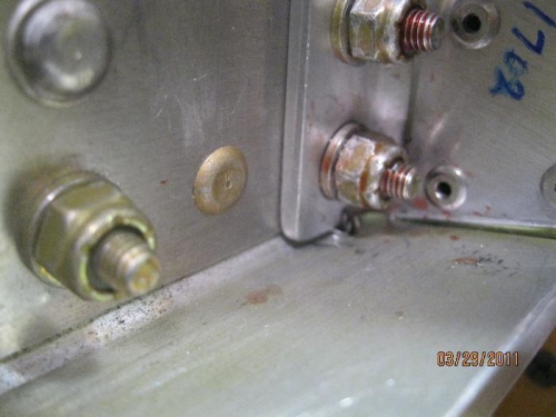

In the 3rd picture the cleco is close to the rib bracket and nut. This will have to be corrected by removing the bracket and carving out a small area for the rivet.
