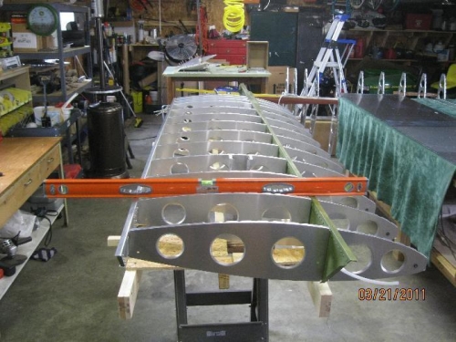

Brief Description:  Level wings to eliminate twist.
This is the first log entry since returning from wintering in Venice Florida, Ben Graber stopped by to check on my progress and provided some very helpful information on leveling and pilot drilling the skin and ribs. Thanks Ben.

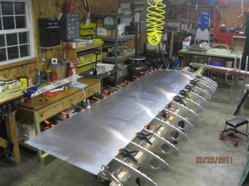

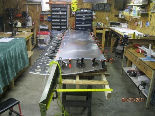

After leveling, I clamped the skin sheet into place and all pilot holes lined up perfectly with the rivets in the rear and main spar and the ribs.
Shimmed the rear spar to level with the main spar at both ends.
Clamped sheet into place.
All pilot holes lined up perfect with the rivets in the Rear and Main Spar.
