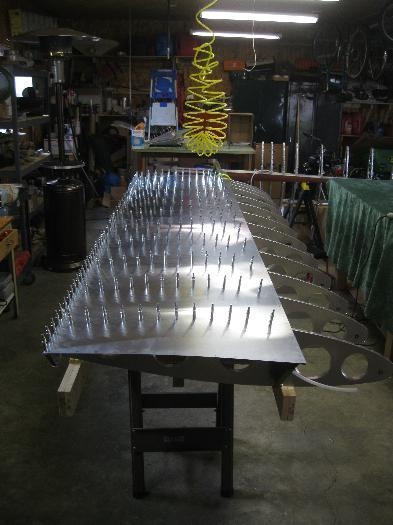

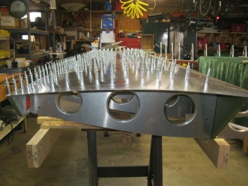

Brief Description:  Pilot drilled and clecoed top wing skin, ribs.
Today I verified again that the wing structure was level and then started pilot drilling the wing skin and ribs. Drilling went well however the first pilot hole in outboard main spar is a little close to the end but but is still within tolerance.
