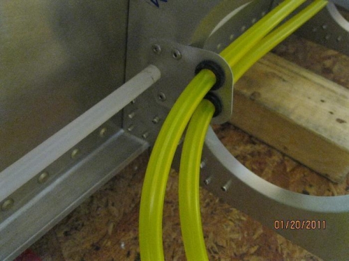

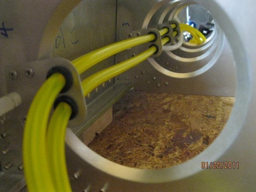

Brief Description:  Ream holes in forward ribs for tubing.
Today I reamed out to 3/8 in holes in the forward ribs for Tygon tubing used for the Pitot tube and Static vent. After reaming I sanded and deburred all ribs, inserted rubber gromets and ran the tubing.
The Aft top wing skin is laying in position but has not been clamped. It will be removed and the rib flanges will be lined with a blue Sharpie.
Fwd rib and tubing
Fwd rib and tubing
Fwd rib and tubing
Fwd rib and tubing
