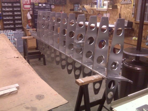

Today I made 16 Web Spacers W14-03 and 20 Center Spacers W14-02. I pilot drilled and clecoed the Aft and Forward Ribs, Center and Web Spacers to the right Main Spar. I Clecoed the Rear Spar to the Aft Ribs.
Aft and Fwd Ribs, Main Spar

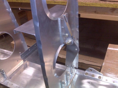

Right Rib #9 with Bell Crank.

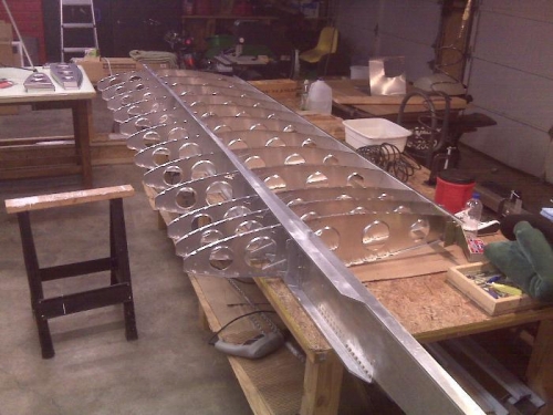

Wing Clecoed with Rear Spar.
