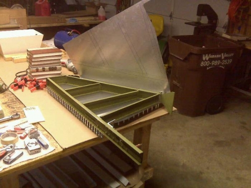

Brief Description:  Assemble painted Vertical tail parts.
Assemble painted Vertical tail parts and found that rib 2 extended to far out at the aft spar. I remade rib #2, prepped, and primed. Riveted together the complete vertical stab. I then layed the vert stab frame onto the skin and marked the location of the ribs. All ribs line up with the predrilled pilot holes in the skin.
Completed Vert StabFrame.
