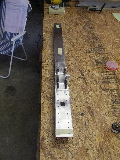

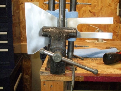

Remade the forward tail spar assembly and it is off 1/8 in between ribs 3 & 4. I can fix this by making a new rib 3. T12-05 angle needs to be 1/8 in below the main rear spar upper/lower half. My result was 1/16 in. So I will work that out next. I also used the suggestion from the Sonex builders group to bend the Forward Spar Fitting. Worked really well.
Tail main spar
Tail main spar

Bending Fwd Spar Fitting.
