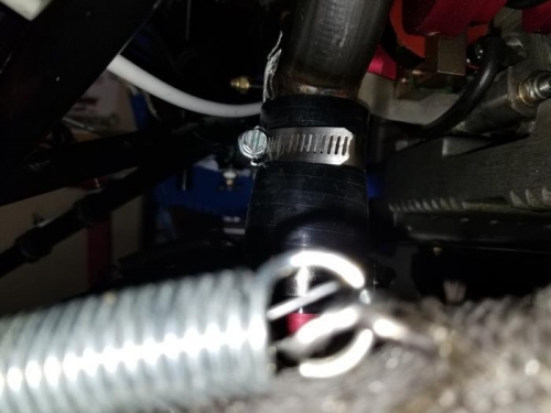

Today we worked on several things. We applied the N number to botto the carburatorh sides. looks great. I made the cable fairings. Jake and I removed and trimmed the flap handle because it contacted the fresh air scat hose. Jake trimmed the top of the flap handle also. Jake and Jjeff secured more wires including the spark plugs above and below. Also made a bracket to secure the throttle cable. We also shortened up the fuel line a couple of inches. Jake safety wired the carb and also found a clamp on the lower intake that connects the carb that was cracked and probably would have failed. We used red RTV to seal up the firewall the openings.The last item was to install the cowling. The bottom cowl went on well but the top has a couple of fit issues that will need to be resolved.

Thsi was the cracked clamp we replaced.
