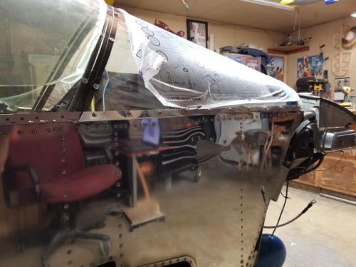

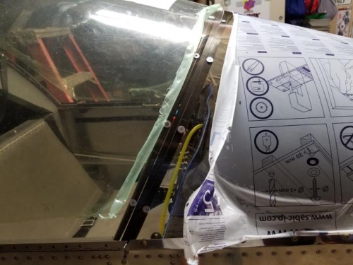

Brief Description:  Finish the final installation of the windscreen an
Tonight we installed the final screws and nuts on the windscreen and canopy. We found a very small crack on the lower Canopy forward hoop at the screw fastener. It is very small and may not have been a problem, howe ver we still drill stopped it. We also compressed the front landing gear spring with 2 needle nose vice grips to allow for the bolt to be installed in the gear strut.
