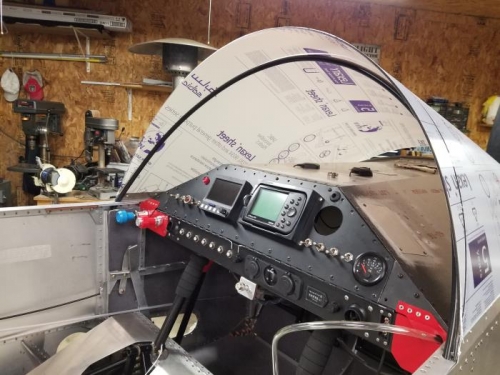

Brief Description:  Installed the windshield hoop.
I fit the windshield hoop and test fit the windshield. I cut the hoop 1.5 inches taller than what was in the plans in order to increase the headroom in the canopy. However I was not comfortable with how the windshield would have to be cut and also worried that I would not have enough canopy material if I tried to add the additional headroom. I removed and then cut the hoop 1/2 in over the plan specs. from reading others post there will be enough material for this modification.
On the first fitting the windshiels rest on hoop.

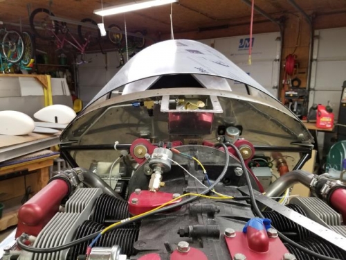

2.5 inches above the upper firewall strap.
