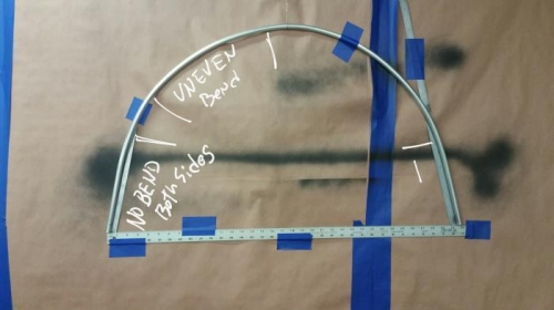

Date:  4-16-2018
Manual Reference:  D02
Brief Description:  Prepare windshield Bow.
Today I pulled out the windshield bow and verified the measurements to the plans. The bow is the correct length but the diameter is to short. I tried to make it fit however after getting it in, each upper longeron was pulled in about 3/4 in. I called Sonex and they are shipping me a new bow.
