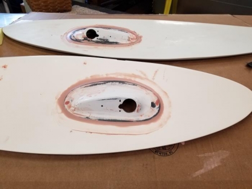

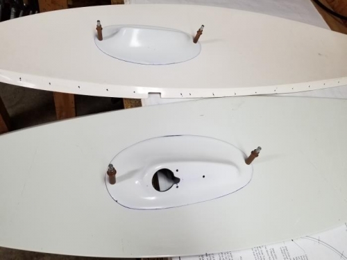

Bond position light pods to the wing tips.
Used 80 grit sand paper to rough up the area wre the position light pods would be mounted. I used T-88 Epoxy adhisive and the bond is super strong.
I used clecos to secure while the epoxy setup.
