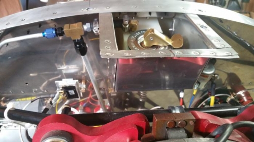

Brief Description:  Bend and install the fuel tank vent tube.

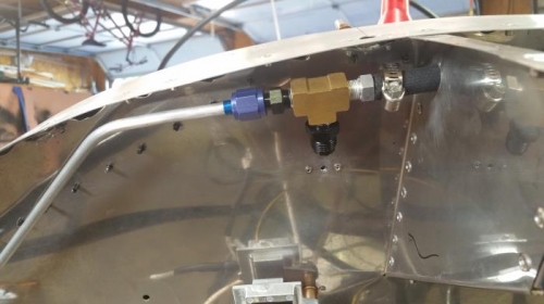

Today I bent and installed the fuel tank vent tube. I also install a tee and vent tube to vent the fuel just before the carb. The idea is to allow air bubbles that cause the infamous burps, to escape before entering the carb. The idea has been around for some time but is not part of the Sonex plans.
Fuel vent tube. and Tee.
Additional vent tube for the carb.
