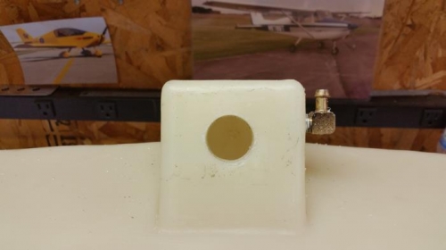

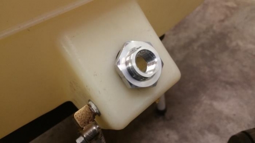

Brief Description:  Remove the Fuel tank 3/8 fitting. Install Oops fi
I finally decided to remove the factory fuel tank fittings and install the more reliable Oops fittings. I used the tool the Jeff Logan made to cutout the fitting. It worked great. I emailed Dave Amsler who has made a tool to remove the flanged area around the fitting on the inside of the tank. His tool is currently loaned out but he will send it to me as soon as it comes back.
After cutting out old fitting.
Just temporary to see how it fit.
