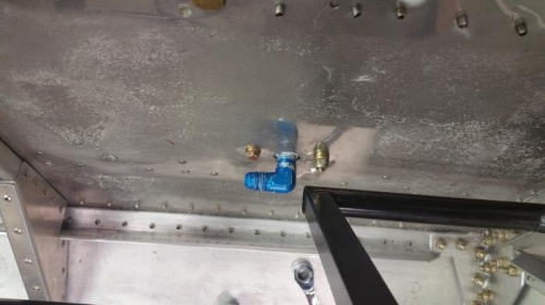

Brief Description:  Install gascolator again.
I had previously removed the gascolator and considered coming straight from the fuel tank through the firewall and using steal reinforced fuel line. I have re-though it and will try the gascolator. I will use the flexible line to the firewall and then use aluminum to the gascolator. The flexible line should help prevent problems with the fuel tank fitting that a lot of builders are having.
Back in at the original location.
