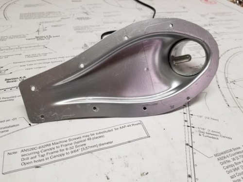

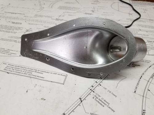

Brief Description:  Installed an outside air tempature probe.
I installed a MGL tempature probe. It is installed in the pilot side fresh air NACA vent. I also hooked up the clylinder head tempature probes to the Remote Data Acquisition Computer (RDAC) and verified correct display on the Electronic Flight Information System (EFIS). I then hooked up the tachometer rev counter to the RDAC.
The probe is out of sight.
