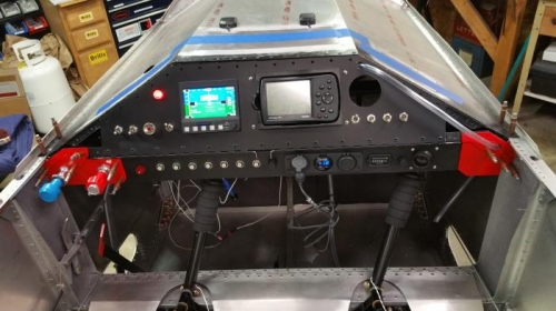

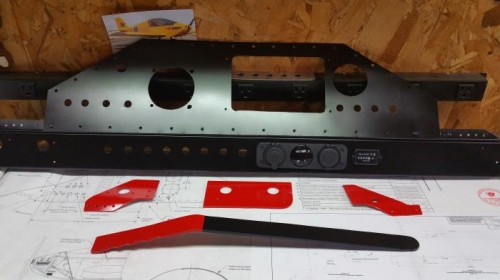

Removed all instruments and wiring in order to rework the panel to add a hinge at the bottom. The additional thickness of the hinge required new corner attach brackets for the left and right. I painted the panel and parts. After considerable though I decided to add holes for a fuel sight tube. I have the fuel probe, but I also had room on the panel. So why not?
Original panel
Original panel
Added hinge between the upper and lower panel.
Easier to work on.
Easier to work on.
