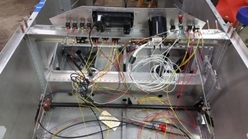

Brief Description:  Cutting and crimping terminals on wires for the in
Cutting and crimping terminals on wires for the instrument panel. Using all Mil-Spec wire. Mostly 18 gauge, some 20 gauge on the instruments. Firewall forward is Mil-Spec 6, 8, 10, and 12 gauge wire. Also install the control stick grips with the PTT (push to talk) button....
Instrument Panel.
Instrument Panel.
Back of instrument panel.
