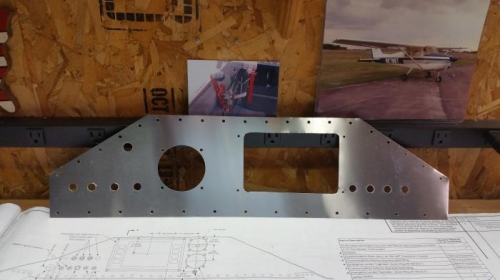

Brief Description:  Still working on the Panel layout.

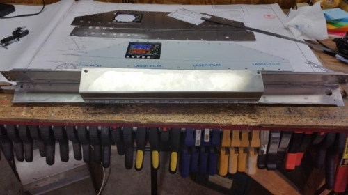

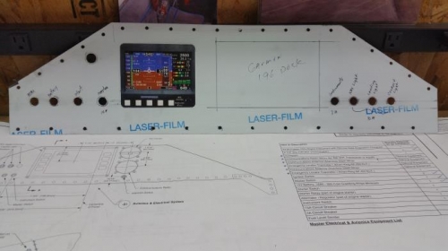

Previous plan did not work. The breakers are to close to the bottom cross member. I am now cutting out panel number 5 and will install the electrical breakers below the instrument panel. I used a flycutter to cut out the hole to install the MGL EFIS. I have decided for now to install my Garmin 196 Aviation GPS rather than the Ipad mini. I cut out the hole for the Garmin and installed brackets behind the panel. I finished by cutting the holes for the switches and the breakers in the new extension below the panel.
Added a removable cover to the lower panel space.
