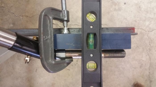

Brief Description:  Check gear toe-in.

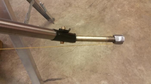

After getting the sonex down on its gear I was concerned that the main gear appeared to be toed-out. I looked it over several times from different angles and was convinced that I had a toe-out on both main gear. So this morning I removed the wheels and brakes and checked the alignment again with the alignment too and it is correct. I also stretched a string from the front edge tip of each axle. It is visually correctshows the axles are toe-in. so I put it all back together and it still looks like toe-out. But it is OK.
Looks ok with the toe-in tool.
String indicates a slight toe-in also.
String stretched between each axle tip.
