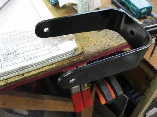

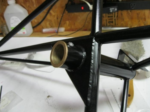

The front landing gear is powder coated and I spent a lot of time removing it in order to accept the large bushings. Tthe inside of the engine mount that accepts the landing gear also had to have powder coat removed. After the bushings were in I drilled and tapped 10-32 screws to lock the each bushing to the engine mount. Also drilled the the missing 3/8 inch hole in the landing gear fork. Everything pretty average stuff but seemed like it took longer than it should have.
Front gear fork axle holes drilled..
Bushings top and bottom with set screws.

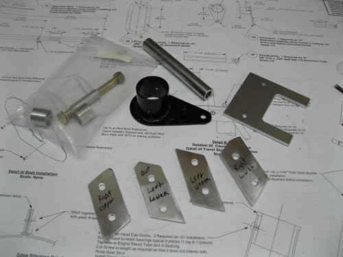

some additional parts to finish up the front gear.
