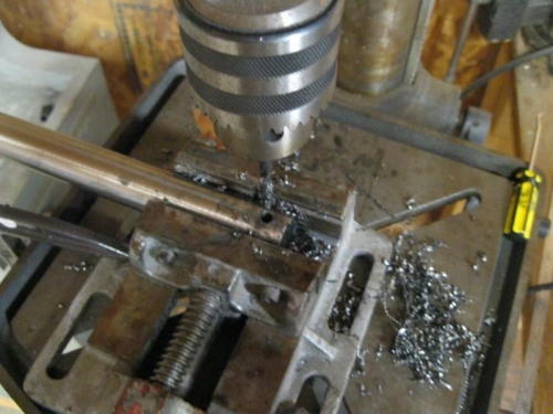

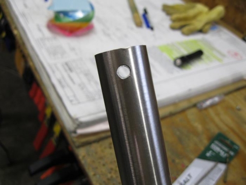

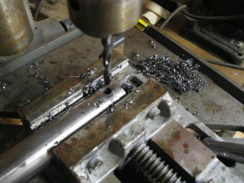

Remove broken bit and Drill gear leg .
I used a 1/8 inch carbide drill bit to drill from the back side to the broken 1/8 inch bit and then punch it out. I went back and updrilled the original hole to 1/4 inch for a perfect hole.
