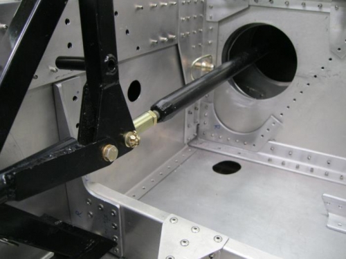

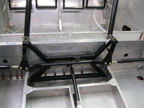

Brief Description:  Installed the Aileron and Flaps controls
Today I installed the Flaps and Ailerons and completed the temporary attachments of the Aileron and Elevator contriol surfaces. There was nothing to difficult about that. I installed the push rod control for the flaps however getting into the lightning hole to connect the flap push rod to the flap drive is very difficult.
