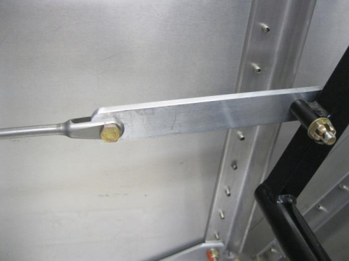

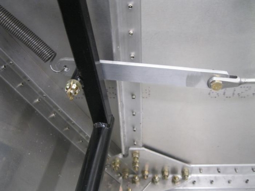

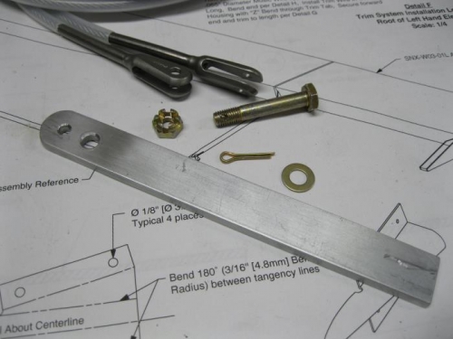

Brief Description:  Build cable adjusters. Install rudder cables.
Adjusted and installed the rudder cables to the rudder pedal adjusters. The rudder return springs were much more difficult than it shoud have been. Cut and bend, install, check tension, remove. I did that about ten times. I just am not certain what the tension shoud be. The instructions are to have equal tension so that the rudder returns to neutral. OK i get it, but there does not seem to be enough rudder preasure. I'll check with Sonex on this.
Rudder adjuster.
Rudder adjuster.
Installed.
Installed.
Rudder, Spring and adjuster.
