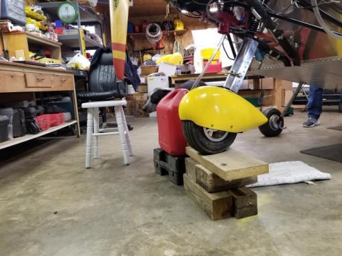

Brief Description:  Performed the FAA required Fuel Flow test.
Today I performed the FAA required Fuel Flow test. Test one was 37.1 gallons per hour. Test 2 was 30.3 gallons per hour. Raised up the nose wheel until the tail skid was touching the floor.
