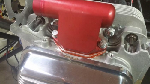

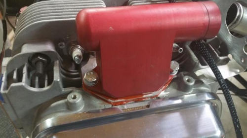

The 30mm studs provided by Sonex for the heads to fasten the manifolds were a little to short to accommadte both the the spacer and the intake manifolds. I elected to use 40mm hex bolts instead. After cleaning the heads, spacers and intakes, I Used red Permatex RTV under the spacer and under the intake manifolds.
Intake manifold.
Intake manifold.
