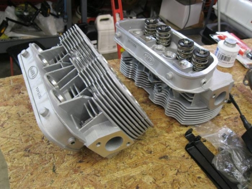

Brief Description:  Install the new cylinders, pistons heads.

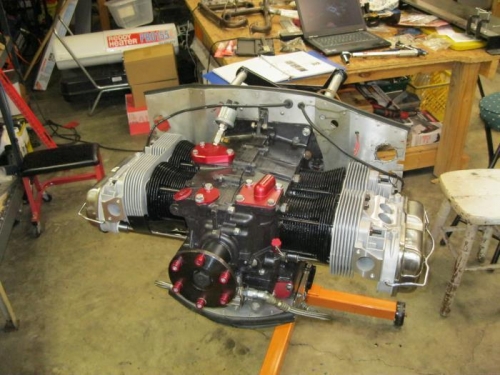

Today I installed the new pistons, rings, cylinders and heads. The new, and rather cheap piston ring compressor worked very well. The pistons and rings needed to be removed to check the ring gap in the cylinder. Then back into the cylinder and install the cylinder to check the deck height. the back off to install spacers based on deck height. Repeat the process three more times and then install the heads.
Cleaning burrs from new heads.
Right side finished.
All four cylinder and heads back on.
