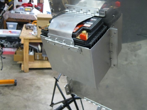

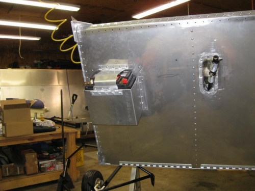

Brief Description:  Build and install battery box.
I had to change the battery box after discovering that I can not install or remove the battery with the engine mount on. I re-checked the plans and the box is installed in the correct position per the plans. I did not care for the plans battery box anyway so I am making a new one out of .040 aluminum. I am doing something a little different in order to use the previously drilled holes in the firewall. I like how it turned out and there is no interference with the engine mount. Next I'll get the Voltage regulator and secondary ignition coils and the RDAC intalled on the firewall.

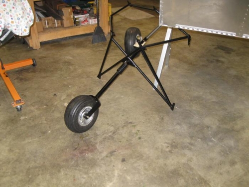

Removed the engine mount.
Battery Box
Battery Box
