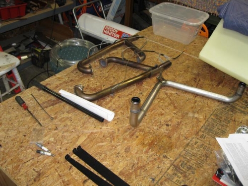

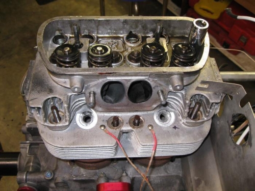

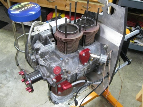

Brief Description:  Remove Right cylinder head and cylinder.
I have all 4 top spark plugs seized in the cylinders. The construction manual specifically instructs the builder to use anti-seize on the spark plugs. I am going to replace both heads and hope the pistons and cylinders look ok. Cost $531 plus shipping. I removed the intakes, exhaust and baffles to get to heads off. The rocker assembly removed easily and the and the push rod and tubes were easy and they look good. The cylinders will need to come off to inspect the piston and rings. Spent some time cleaning everything. lots of oil even though I had the bottom oil plug removed for about a month.
Intakes and exhaust removed.
Rocker arm removed.
Rocker arm removed.
Cylinder heads off.
Cylinder heads off.
