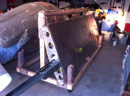

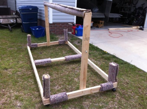

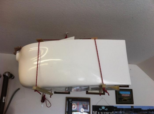

Now that the right wing was done I needed a place to put it while I work on the left one. I made this inexpensive wing rack with some casters, 2x4's, some left over carpet padding, 2 eyebolts, some wire, some screws, and a staple gun. It works great! I used to store my cowling under my work bench and my engine boxes next to the plane but since I needed room the cowling got hoisted up to the ceiling, and the boxes are now under the work bench. This leaves the spot for the wings open.
All done
All done
Cowling in the new place
wing rack with R wing in storage
