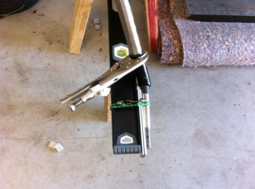

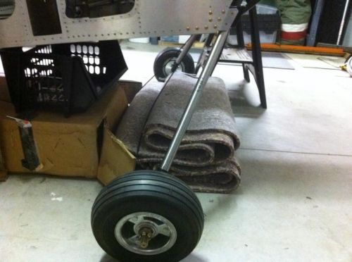

Brief Description:  Setting Toe in and drilling axles
I got the legs mounted and the axles rigged for toe-in. I needed to use some spacers to clear the weldment but it was easy enough. In the picture you can see how I had the left leg rigged. I got the axles drilled, brakes mounted, and bearing packed with grease and tires mounted. Gear are basically done but I need to order a longer brake cable.
.07 degree toe-in
.07 degree toe-in
