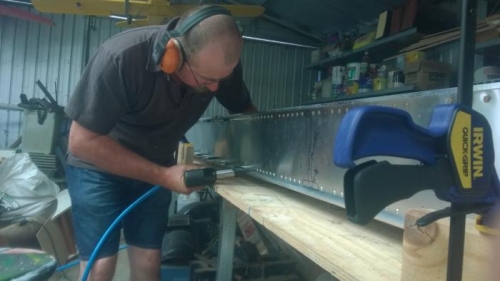

Many hours later, up drilling holes and deburring. I have almost now finished rivetting up the spar. I had to remove the spring from around the front of the gun so that it would fit onto the heads of the rivets on the inboard section due to the shape of the spar cap which gets in the way.
Rivetting main spar
Rivetting main spar
