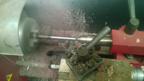

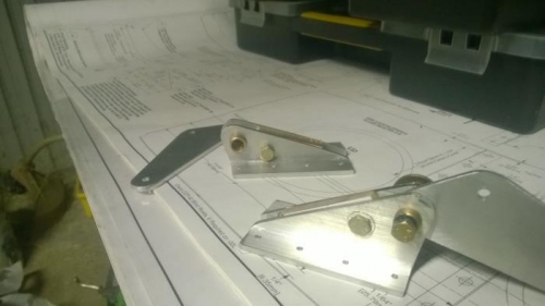

Brief Description:  Aileron bell cranks
It's taken quite a while, but they are almost complete. Luckily the finished one is beautiful, no slop and no binding. I heated the aluminium brackets which made pushing in the bushes very easy, plus they will not come loose. I didn't get any of the inner sleeves from Aircraft spruce which mean't an hours work on the lathe, but it actually made it easier to custom fit the sleeves.
Turning up bush for bell crank
Almost completed bell cranks
