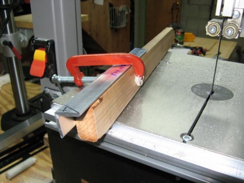

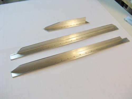

Fabricated several angle parts from 1" x 1" x 1/8" angle stock:
* Gear Attach Angle F14-11R
* Rudder Pedal Angles F14-07R and F14-07L
Cut 5 more pieces to length to work on tomorrow.
Ready to cut

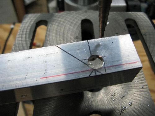

Using Unibit to radius the angle
Finished angle pieces
