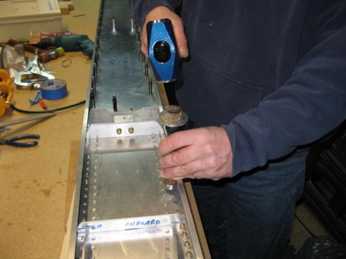

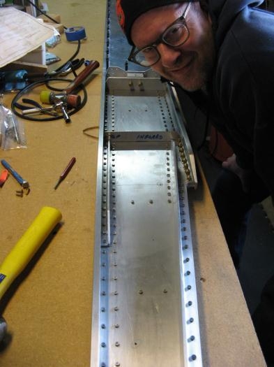

Third Builder Assist session with Jeff Paris. The RH spar is completely riveted and today we worked on the LH main spar. It was further along than the RH spar, since I had already finished the drilling, dimpling, countersinking and deburring of all the parts and angles. Just the final bolt holes remained to be drilled.
We clecoed and reassembled the LH spar. Completed the final riveting and attached all the bolted and machine screwed parts. Final torqued all bolts and screws on both main spars.
Both main spars are now complete except for removing some minor dings made by the tooling during riveting.
Jeff has provided a hard copy Builder's Assistance Log with his own description and pictures of the work we did together.
Jeff inspects our work
Bucking bar setup for  hand riveting
Hand riveting next to spar cap
