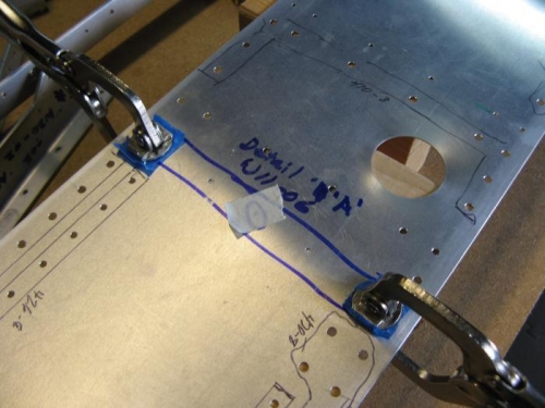

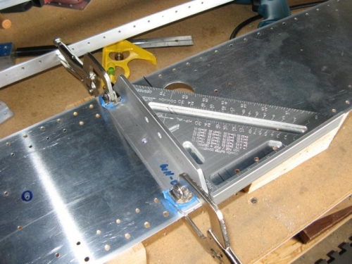

Wing RH Main Spar - drilling angles
Drilled #40 holes in W11-06R outer attach block angle. Used Main Web pilot holes to guide.
Clamped in place
Drilled from the back
