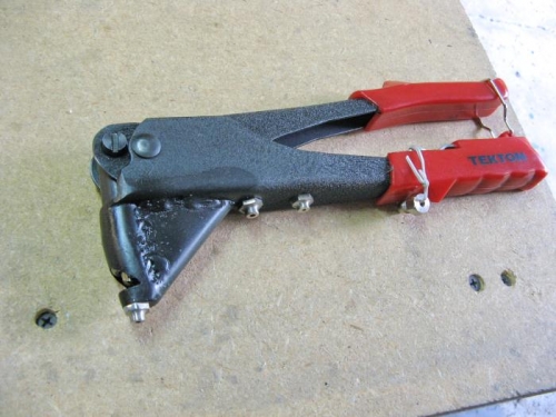

Brief Description:  Modified rivet puller for tight spaces
My friend and fellow EAA Chapter 44 member, David Amsler (Sonex 1327) modified this hand riveter for work in tight spaces, such as installing the wing ribs. After grinding away some of the structure around the head, he welded in the "throat" for strength. Nevertheless, he cautions against using it on any thicker rivets than what we use in the Sonex.
Tight space rivet puller
