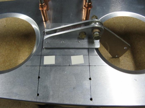

Seems like no matter how hard I try to clamp two slippery aluminum pieces together before drilling, they always seem to move just slightly. And they can be a bear to hold in position just to clamp them.
The ANSWER, my friends, is DOUBLE-SIDED CARPET TAPE! Got a roll at Ace Hardware (SKU 50106). It makes it much easier to position pieces accurately, and they hold still while clamping and drilling. Why didn't I do this sooner!?

Using double-sided tape to position bellcrank assembly for drilling
