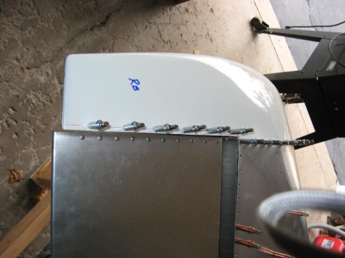

Brief Description:  Horiz Tail: Fitting RH Fiberglass Tip
* Fitted and drilled RH fiberglass tip in place.
* HOWEVER: Found out on removal that the tip rib inside had moved and the holes in the rib are now figure eight shaped. I will have to order new tip ribs.
RH Tip topside
RH Tip topside
