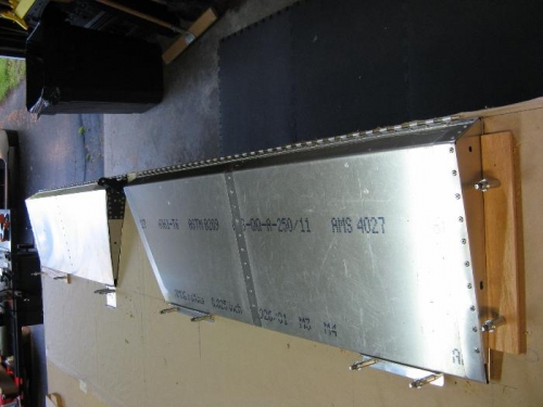

* Jigged both elevator halves into correct side to side position

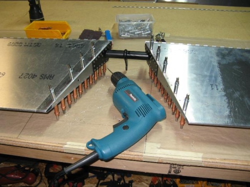

* Placed Elevator Root Rib Assembly into position and drilled pilot holes.
* Deburred and clecoed.
Elevators jigged side to side
Root Rib Assembly clecoed in place
Good rivet lines down the center
