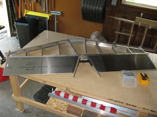

Date:  8-3-2009
Number of Hours:  1.00
Manual Reference:  T02
Brief Description:  Horiz Tail: Position elevator hinges on HS
* Clecoed piano hinge halves on rear edge of HS and matched up elevator hinges.
* Then marked where root rib assembly should go to tie the elevators together.
Locating side to side position of elevators before riveting root rib assembly
