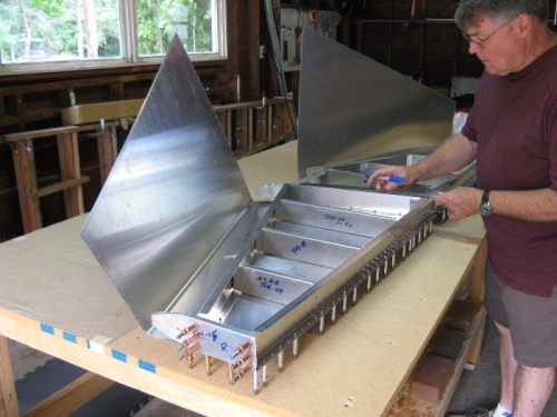

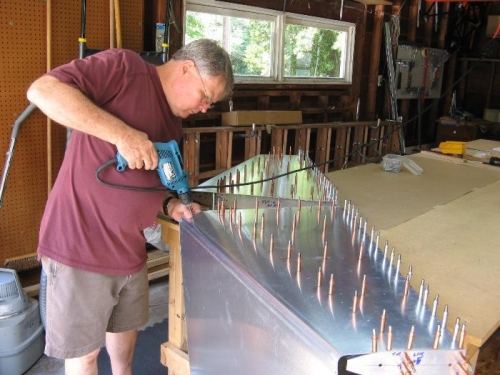

Brief Description:  Horiz Tail: Drill up top skin to #30 and debur
* Deburred top skin and #30 holes in top of frame.

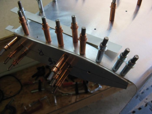

* Marked rib centerlines on bottom of frame.
* Drilled tip ribs. Inserted scrap strips of fiberglass to simulate fiberglass tips for an accurate fit.
Mark rib centerlines on bottom
Drilling top skin up to #30's
