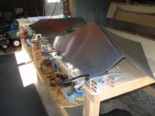

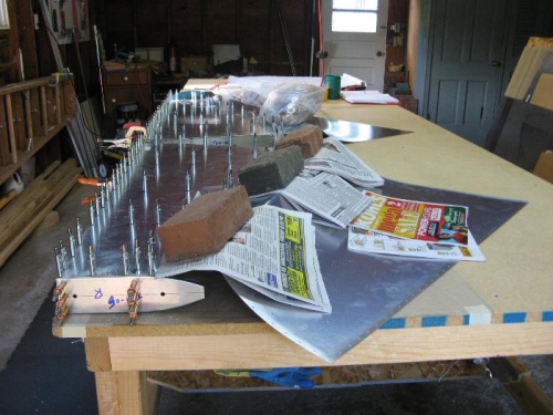

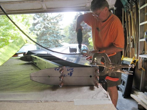

Brief Description:  Horiz Tail: Pilot drill top skin to HS frame
* Clamped frame to straight line drawn on table.
* Drilled #40 pilot holes into frame members and clecoed.
* Used small scrap pieces of channel clecoed to table as jigs to hold frame from shifting sideways.
Top side skin clamped at rear edge
Drilling #40 pilot holes
Top skin is drilled and clecoed
